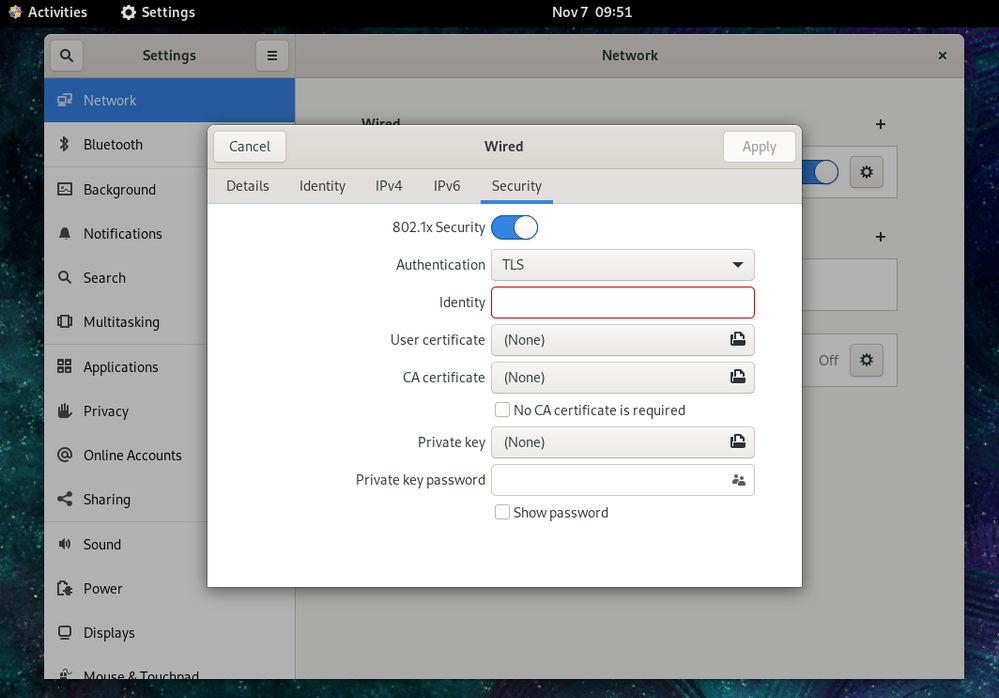

I have successfully configured EAP-TLS on RHEL 7 & 8 in the past (including configuration using Ansible). You need to ensure the client has the Root CA certificate chain (ideally signed by the same CA as the ISE EAP certificate), the private key for the identity certificate (the private key must be secured with a password), and the identity certificate. The supplicant would then be configured to use those three objects similar to the following example screenshot.
The 'Identity' field is optional, but can be useful as a matching condition in the ISE Policy to differentiate it from other use cases.

Interesting. When I briefly had a play with this, the interface was expecting a password for the private key. I was unable to configure the supplicant without the password that protects the private key. That's not an 802.1X thing - it's a security mechanism in the Linux supplicant to protect the private key. It should be possible in your case too. BTW, if your private key is currently not password protected, then you can add a password to it with openssl - just search the web for the openssl command.
The identity is only the 'outer' identity that is used for the RADIUS User-Name. You should put some text string in there, even if the string is something like "anonymous".
