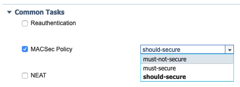

In regard to ISE licensing, the base session licenses are what you need to support link encryption (MACsec).  Not sure what version you are running, but please note that as of late 2020 and ISE 3.0 there is a new licensing scheme introduced.  See below for further detail:

MACsec is really a feature of the switch and endpoint that ISE has the option to require as part of the endpoint authorizations. It is a basic RADIUS feature in the Base (2.x) and Essentials (3.x) licenses.
