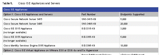

I don't know where you got 200 as the max number of endpoints. The 3415 can handle up to 5000 endpoints. See this screenshot from the ordering guide:
You only need an Inline Posture Node if you have users connecting to your network through an off-site VPN Connection. THE IPN handles the CoA behind the ASA. ASA 9.2.1 (not yet released) will be able to handle C0A and at that time, no IPN will be needed.
SNS-3415 and SNS-3495 can definitely be used together in the same network, but your deployment plans will not. You license the ISE deployment-wide. For example, you can license for wireless only, but that would make the entire deployment wireless only. To have 2 separate deployments of ISE in a network is NOT supported and will create issues.

Hi Moreton,
Thanks for your reply and for the screenshot.
