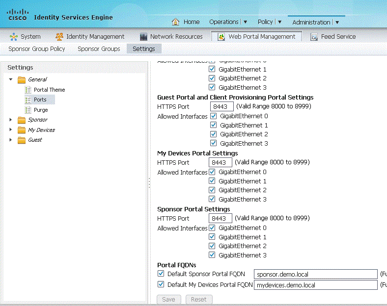

Hi Charles,Thanks for the reply but i think ur ISE is the latest one. Ho about in ISE 1.2 do you think I will encounter a problem regarding my setup?Thanks
Nikko,
For ISE 1.2 and 1.2.1, Go to Administration > Web Portal Management > Settings
On the left Menu, under General, select Ports.  Here is where you select the interface on which the portals respond.
Remember to Save.
