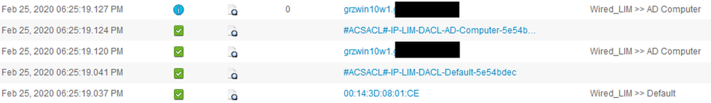

Just to add a note for something I recently discovered... while Concurrent Auth is not technically understood or supported by ISE (as Hsing has confirmed), I have used it successfully in my lab and some customer environments with newer switching platforms (Cat 3650/3850 or newer).
I also found recently that a mechanism used to prevent reauthentications breaking FlexAuth (order mab dot1x, priority dot1x mab) in the Legacy IBNS framework also works to make the Concurrent Auth more efficient for dot1x-enabled endpoints. See this old Whitepaper for background:
Flexible Authentication Order, Priority, and Failed Authentication
The behaviour of the typical Concurrent Auth config is similar to that of FlexAuth Case 2 in the above whitepaper (order MAB Dot1x, priority Dot1x MAB). When a reauth is triggered, the switch will try MAB first then Dot1x and the ISE logs will reflect that. If you add the Advanced Attribute Cisco av-pair stated in the footnote of the whitepaper (termination-action-modifier=1) to the AuthZ Profile used by your dot1x endpoints (like SOE PCs), when a reauth is triggered (does not apply to a new session by disconnect/reconnect) the switch will only try the last successful auth method (in this case, dot1x). This results in more efficient reauths and much fewer erroneous MAB sessions/logs.
I've tested this using a Cat9300 running 16.9.4 code, but it should also work with the Cat3650/3850 switches.
Example before:
Example after:
Cheers,
Greg
