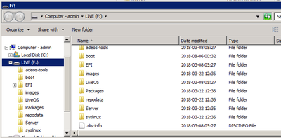

We are updating the doc as attached. Let us know if you have further question or inputs on it.image001.png

CSCvi15283 clarifies that liveusb-creator 3.12.0 tested by our team and older/newer releases might not work. In fact, Fedora Writer 4.1 results a USB thumb drive not recognized by Windows so the files not editable.
Please ignore my previous comment about the files not there, as my USB thumb drive at the time had some other Linux distro.
