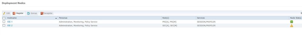

I'm running an ISE lab for practice. I am failing to register an ISE node:
When I hover over the exclamation point, it says:
Registration Failed
Sync Status: Node Registration or Sync failed. Please de-register and register the node again

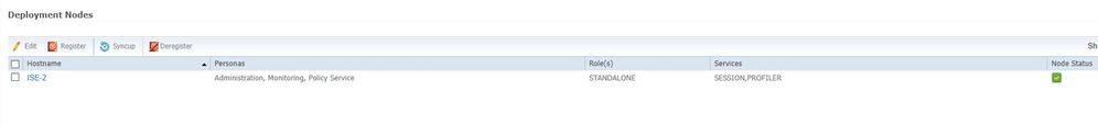

On my Secondary ISE node, it still thinks it's a standalone deployment:

This has been resolved. It was related to bad network connectivity between the two ISE nodes.
