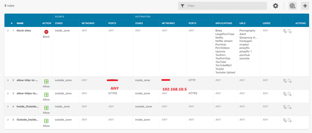

Can I see ACL of ftd you use for this traffic
MHM
yes..
these are my current ACL
