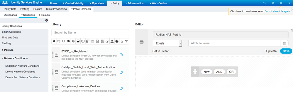

Create one authorization rule with condition as RADIUS:NAS-Port-Id equals Endpoints:AssignedPort

RADIUS protocol send port number in radius attribute so you can use this attribute to configure a condition:

You can use endpoint custom attributes.
Create a custom attribute with name say "AssignedPort" and type as String.
Edit the endpoint at Context Visibility > Endpoints > Edit > Custom Attributes > AssignedPort. Enter the value as "GigabitEthernet1/0/2" (this is just an example).
