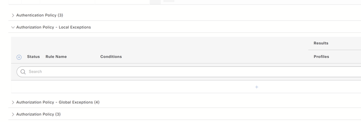

May I ask how to define the condition for an exception rule ?
@tonyang just create an authorization rule (as per the example provided) under either the Policy Set Local Exceptions or Global Exceptions, these rules will be processed prior to the Authorization Policy.

I just implemented one local exception to manage the blacklist. And it works smoothly in my environment. I am wondering if I can have alternative to do. Like use AD group (security group) to manage/control.
Thank you, Rob.
I implement the block list in the authorization policy. I just implement radius protocol in the authentication policy. And move the block list to the top among multiple authorization conditions.
