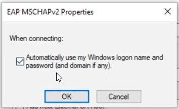

Here is all of the configuration that i've done up to this point:

NPS Configuration
Endpoint NIC Conifg

thomas
It depends on your endpoint supplicant configuration.
One of the options should be for it to automatically provide the user's login credentials:
If you have this checked it will NOT prompt for the username/password!
Hi Thomas,
Thanks so much for replying. I've unchecked that hoping that it will prompt for a username and password and it still doesn't.
Do you have any other thoughts. Have you seen IBNS 2.0 work with Microsoft NPS server before?  I literally can only find configurations with ISE or using non IBNS 2.0 configurations.
