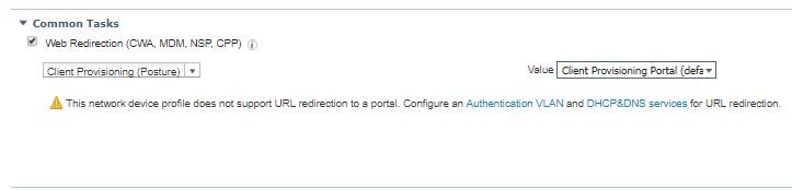

Yes, that would be right place to check. The profile that I had imported in ISE states that there is no URL redirection supported:
Again, using auth VLAN here is no feasible, considering the number of sites that they have with Juniper switches.
What I am thinking of using calling home list for all the endpoints that are there for these specific sites, thus eliminating the need to a redirection.
But then I am still looking for a solution to configure Guest redirection on wired network?
Any ideas how could this be accomplished using this current Juniper profile?
