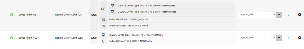

I am using ISE as an example, but you can do this with NPS as well. Here are the RADIUS attributes that you must match on when processing RADIUS AAA requests from Cisco IOS and AireOS:
The RADIUS Access-Accept for IOS devices must then contain the priv level. I didn't keep the screenshot of that attribute, but it's a Cisco AVPair.
cisco-avpair= ”shell:priv-lvl=15“
One thing I will note is that when implementing IOS AAA using RADIUS, is that you can't get per-command authorization - that requires TACACS+. But if you simply want to log users into your IOS devices, then RADIUS is just fine. I have an issue understanding IOS priv levels and as such I always assign priv15 to all users, and then limit their access using command authorization. The command "show running-config" requires priv 15. But if I want to allow a junior engineer access to see all configs, but have no conf t access, then I still give them priv 15. But that requires TACACS+.
