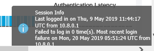

The timezone thing in ISE 2.2 is utterly confusing, as for example the popups shown upon login are able to make it perfectly clear what time it was when the admin logged in. But only in the popup, message but not in the audit log for administrator logins
admin login with UTC timestamp.png    admin login report without UTC timestamp.png
