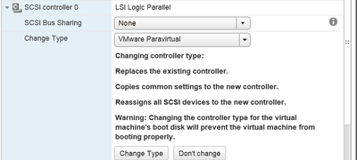

Q2: Somewhat related, SCSI paravirtualization is not enabled by default?  Why?  No paravirtual - ISE VM shut down.png
And when chose it from the dropdown list in vSphere 6.5, I got this warning - can this warning be ignored?
I use pvscsi on all of my VMWare builds when I build the systems from .iso - I believe it's supported by the ISE installs too.
We discussed this previously at A free efficiency boost for ISE in a VMWare deployment. AFAIK no change so it likely needs re-imaging by ISE ISO to effect switching to PVSCSI.
