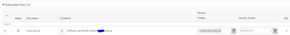

I've created a Profile Policy to match the CDP:
And then call on the logical profile in the Policy set:
But because the ISE never receives the CDP information, it just ends up seeing it as a Cisco-Device and ending up in the Default
I could try creating an exception rule, but that does seem the right way to go.
