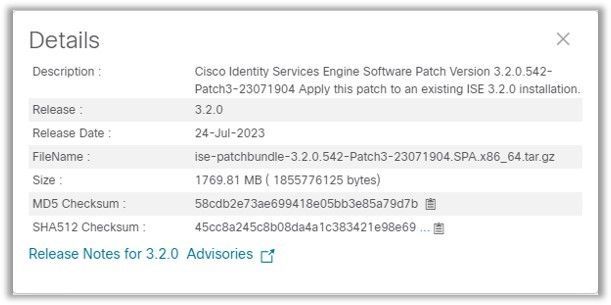

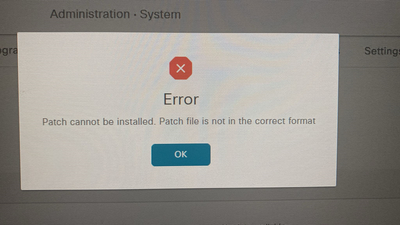

We are trying to apply Patch 3 of ISE 3.2 and found that the downloaded patch file has a wrong checksum as compared to the one specified on the website.
The downloaded patch file cannot be applied, and the error message was:
Any advise?

Yes, this was a known problem last week. You may see the banner on software.cisco.com stating this:
Please try downloading again today. I just did it for ISE 3.2 Patch 3 and I got the correct checksum:
md5 ise-patchbundle-3.2.0.542-Patch3-23071904.SPA.x86_64.tar.gz
MD5 (ise-patchbundle-3.2.0.542-Patch3-23071904.SPA.x86_64.tar.gz) = 58cdb2e73ae699418e05bb3e85a79d7b

@eiklin try downloading again. downloaded file seems like corrupted.
Good luck
KB
We have tried multiple times and downloaded via different ISPs. still same issue.
eiklin
Visitor
Thank you verified ok
