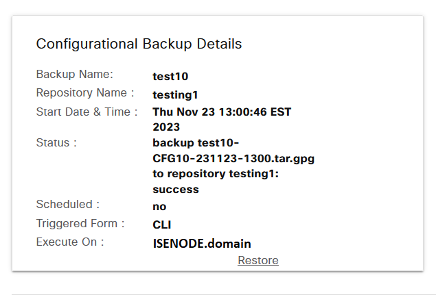

CLI Configuration backup process using an FTP repository created also via CLI is displayed in the GUI even though that repository does not exists there.
GUI listed repository does not show the CLI created FTP repository.
