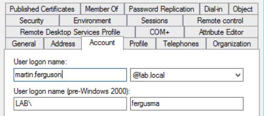

I have a customer that is wanting to use user authentication with user certificates (wired and wireless). ISE is joined to their domain and providing the RADIUS authentication. When ISE receives a user cert it learns the name from the CN or SAN fields, and searches for a valid AD account with matching account name. The way their AD accounts are setup is that the ‘User logon name’ does not match the ‘User logon name (pre-Windows 2000)’ field. Searching for an account by the ‘User logon name’ will fail, but searching for an account by the ‘User logon name (pre-Windows 2000)’ will succeed. The problem we have is that the certificate generated for an account will take the User Principle Name which is the ‘User logon name’ , and not ‘User logon name (pre-Windows 2000)’. ISE will only ever learn the ‘User logon name’ from the cert, and will search for an AD account by that name – which fails. It is a particularly difficult task for the customer to change domain account structures and/or certs. So, the question is, is it possible for ISE to search for domain accounts based on anything other than account name? or, is there any other suggestion about how to make to get this working without changes to the customer domain?

thanks for the reply Paul and Arne. The issue here is that the customer AD accounts look like that attachment. You'll see in this example that 'martin.ferguson@lab.local' is the user logon name, but the pre-Windows 2000 name is actually 'fergusma' - this is what is SAM /account name. So if you search AD for an account name called martin.ferguson it will fail. It will only succeed if you search for fergusma.
When a certificate is generated for this account, it populates the CN and SAN fields with the UPN. The UPN is taken from the logon name - 'martin.ferguson@lab.local' - not the pre-Windows 2000 SAM. So, when using EAP-TLS, ISE will only ever learn martin.ferguson' from the cert info. It will try to search for and account name called 'martin.feruson' and that will fail.
Its a long shot, but I was wondering if there is any way that ISE can search for a UPN rather than SAM, or if anyone had seen this before and had a resolution - other than changing all the AD accounts :)

hi Paul, I couldn't see the attachment with your post, but looks like we have a fix. Your suggestion about the identity source on the cert profile was spot on. Changing this from the default CN to 'Any Subject or Alternative Names Attributes' option sorted it and now ISE appears to be searching by UPN.
FYI, the 'Test User' tool is a little misleading in this situation. If I search by 'martin.ferguson' in the test tool it is a failed result, even though this is the name and format ISE is now finding the account with. It seems the 'Test User' tool only searches on sAMAccountName field, as searching by 'fergusma' in the tool is the only way to get a successful result
