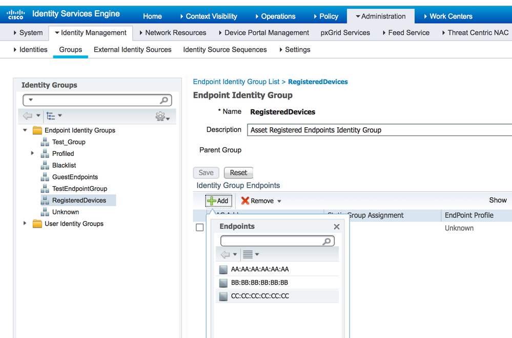

@dodgerfan78 say I may be "trying to add a MAC to a profile condition" - possibly but here's a screenshot now that I'm getting more familiar.  What you see when I click the green "Add" button, I'm wanting to do via API - ie, add MAC address FF:FF:FF:FF:FF:FF to the `RegisteredUsers` Group shown.
