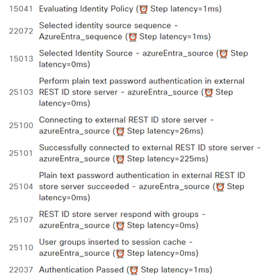

authentication detailed log

This statement is still true. The example screenshot I shared was when using RADIUS for device admin (which does not use the Device Admin Policy Sets) rather than TACACS+

1. even if you said that Authentication for tacacs isn't supported, here are the logs proving that work
2. i am running ise 3.3 path 2 and i wonder if and when such support would be added for authorization
