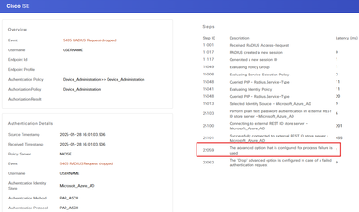

05-28-2025 05:38 AM
Hi Greg
I'm facing this error while trying to perform device administration. Could you please share the document you followed to integrate Azure AD with Cisco ISE via REST ID?(like URL)

05-30-2025 10:07 PM
Hello Greg,
Thank you for your reply. The information you provided is helpful, but I am still facing the same issue.
However, the issue does not occur when calling the on-premises AD instead of Azure AD.
If possible, could you please share the document where you tested this in your environment? I have already completed all the configurations provided in the url you previously shared.

06-01-2025 06:44 PM - edited 06-01-2025 06:47 PM
There is no source documentation for this and my basic lab testing was over 2 years ago, so I cannot recall much detail on how I tested this.
The first thing you should look at is the fact that the log detail shows 'Username = USERNAME' which means it is invalid. You should enable this setting the Admin > System > Settings > Security Settings page to determine what actual Username ISE is getting.
The Username that ISE sees should be the User Principal Name (UPN) in Entra ID without the '@domain.com' suffix. When ISE sends the Username to Entra ID for Authentication (using ROPC), it will append the Username Suffix you have configured in your REST ID settings. If the full UPN is used for the login (user@domain.com), then the resulting username ISE would send to Entra ID would be 'user@domain.com@domain.com' which would result in an error.
Example:
If all else fails, you might try opening a TAC case to investigate further. As this is not a documented use case, the level of support TAC can provide may be limited.
