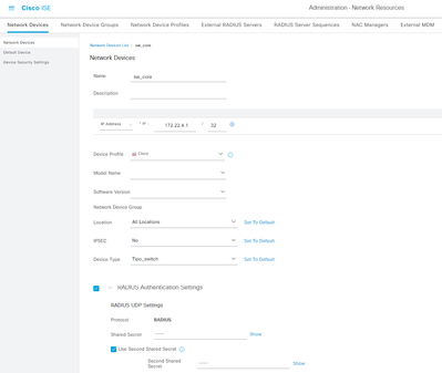

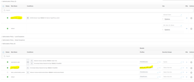

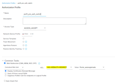

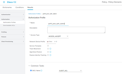

I just recently got it working. I'll leave you the configurations I applied to both the switch and the ISE.

LeoTI_0-1730836856784.pngLeoTI_1-1730836871998.pngLeoTI_2-1730836925167.pngLeoTI_3-1730836940644.png
