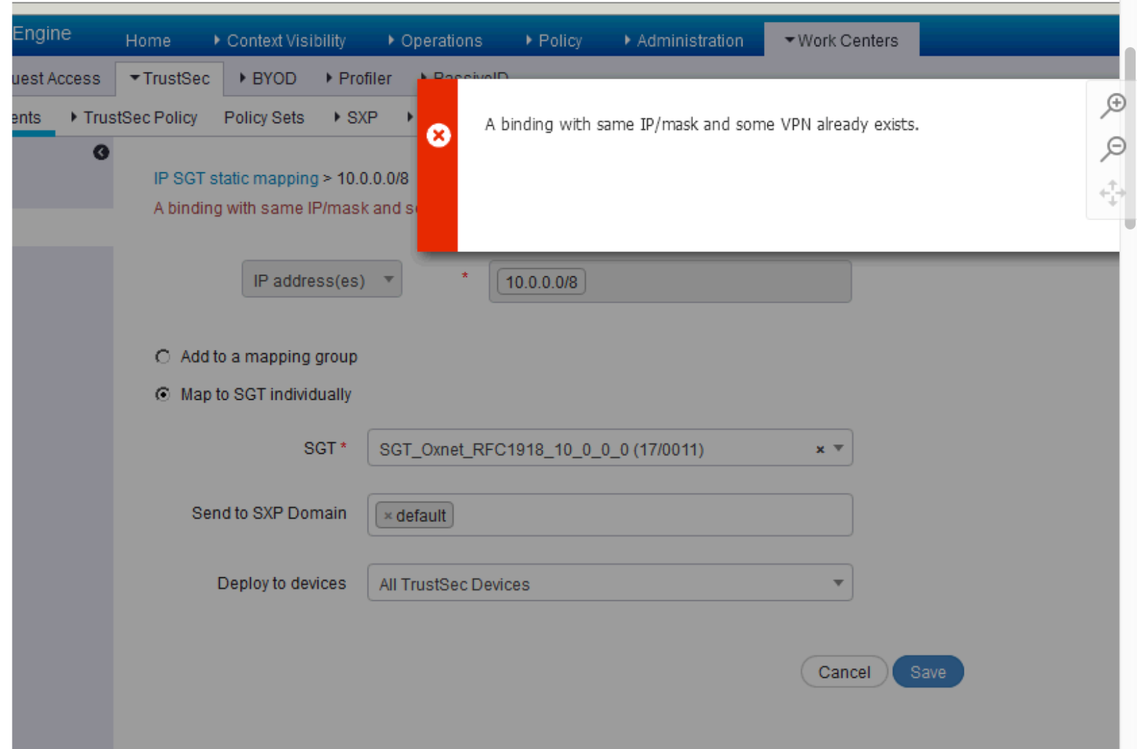

Team , I need some help with SXP config in ISE . We need to duplicate IP-SGT bindings in different VN/VRF's at the borders and we created these via DNAC . In ISE we created different SXP domains one for each VRF at the Borders . However when we map in ISE the IP-SGT bindings to domains first OK while for second we get :
Any feedback or
help highly appreciated

Thank you for reply and looking forward for any feedback .Meanwhile the solution we adopted was to push same IP_SGT binding into multiple domains ....that somehow achieve the same.

This is tracked by CSCuz00603

This seems a known issue. I will confirm it with the teams.
Cheers ,
hslai
Great. I am guessing you meant like this:
Hi Hsing, Krish
Thanks for this link, have not found it before.
Unfortunately my scenario is a bit different then DNA scenario - i can not send the same mapping to two different SXP domains.
That is very interesting that is allowed, while adding "conflicting" mapping not.
I do have a TAC case 685182901 opened and would like to get clarification on our strategy.
If we allow to send the same mapping to multiple SXP domains, why we can not add later the same mapping ? All of them are "duplicated/conflicting". Right ?
It looks like pretty inconsistent approach. Limiting us unnecessarily. Could we have this validation disabled to allow to add duplicated/conflicting mappings ? Do you see any potential risk here ?
Thanks,
Michal
Michal
Agreed, this is all allowed on the switch infrastructure, it's just an ISE implementation anomaly.
You can of course just edit the one mapping entry in ISE and enter more SXP domain destinations.
A fix for individual entries needs to be tracked under CSCuz00603 (multiple exceptions in log with unified ip-sgt functional).
