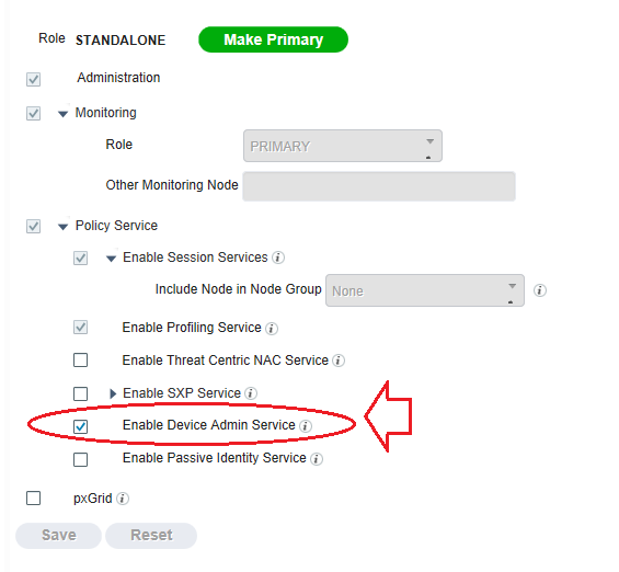

One more detail. To enable TACACS on ISE , check the following box.
