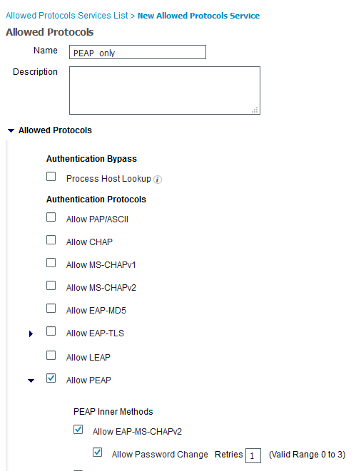

Maybe I missed something, but the way to prevent any Supplicant from succeeding in trying the EAP-TLS is method, is for ISE not to offer it in the TLS negotiation.
If a supplicant requests EAP-TLS and ISE isn't able to offer it, then the conversation ends there.
This is done via the Allowed Protocols section in Authentication.  Create a new Allowed Protocols profile and then only allow EAP-PEAP.
