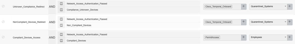

I have configured the posture policy as follows:
The thing is that if connect any other endpoint, the endpoints go through the flow as configured here. That if there is no AnyConnect installed, get the CPP page, install AnyConnect and posture the endpoint get the final access.
If AnyConnect is already installed, then run the posture and get the final access.
The endpoint that I am struggling with, had AnyConnect installed using the above flow. The AnyConnect was uninstalled and endpoint rebooted, and then connected to the network (wired or wireless) both have the same behavior! The endpoint gets the access that is specified in the posture status as compliant!
This is the same endpoint even after deleting the its mad address from ISE, and reconnected to network, still ISE reports it as compliant, thus the endpoint always end up getting the final posture session compliant access.
The other thing is that, if I go to live sessions and terminate its session, then endpoint will start coming through the flow that I have configured as above...!! I hope this clears up the scenario?
