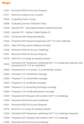

I generated an endpoint certificate provisioned through the ISE portal and installed it on the Android 11 smartphone with the same MAC as the generated certificate.
I also installed the CA ISE certificates on the smartphone:
- Certificate Services Root CA
- Certificates Node CA
- Certificates Services Endpoint Sub CA.
I configured the wireless network on the smartphone:
Security: WPA/WPA2/WPA3-Enterprise
EAP Method: TLS
Identity: <I entered the same user used on the ISE certificate portal>
CA Certificate: Certificate Services Root CA
Note: I also did a test pointing to Certificates Services Endpoint Sub CA.
User certificate: <Endpoint certificate generated in the ISE certificate provisioning portal>
I selected the option to use the device's MAC instead of Random MAC.
Still, I was unsuccessful in authentication, I got the following errors, according to the ISE log:
Hello Rafael,
I'm not an Android guys (smiley face) so please bear with me. The error is clearly stating that the client can't trust ISE local cert. Who is the issuer of the certificate installed in ISE for EAP services?
Hello @Aref Alsouqi
No problem my friend, you've helped me a lot so far.
The certificate issuer installed in ISE for EAP services is Thawte, an external CA.
I understand that in this case I need to install Thawte's Root CA and Intermediate CA certificate on the smartphone, so that it is possible to authenticate via EAP-TLS, correct?
Yes, that's correct, otherwise when ISE presents its certificate which has been issued by Thawte, the smart phone won't trust it unless you import its issuer and you associate it to the SSID profile. Best practice to import the whole chain, however, I think it would be enough to import Thawte root CA cert into the smart phone, also because I think in Android you can select only a single CA certificate in the SSID profile.
