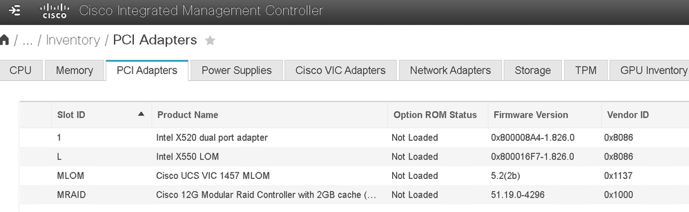

2. How important is Option ROM for MRAID controller? Could this be the issue? (also after HUU for ISE usage and disabling from all unused Option ROM slots, its still not loaded)

Thank you for advice, but the question about Option ROM remains. How important is Option ROM for UEFI secure boot? Because I can see errors in log regarding Signature of some (4) software (unfortunately software name or something usable for identification isn’t  specified in that log)
Could Option ROM be the root case?

I don't know what the "Option ROM Status" really means, because on my UCS C220 M5 I am using RAID and the Network cards, but it says "Not Loaded"
