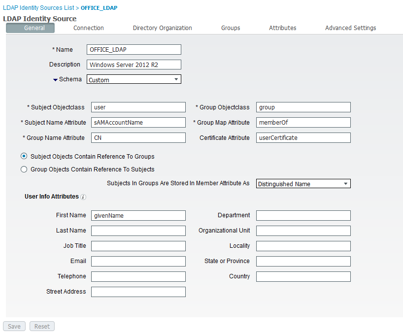

Here is the schema mapping - it's the trickiest part as far as I am concerned - a lot of trial and error to get this woking due to the different names that ISE/Windows/LDAP_Standard use - I hope I got it right

Arne, with your LDAP settings, need to change 'Group Name Attribute' setting to dn instead of cn and re-pull the groups as dn format to make it work. If you look at the memberOf attribute for 'admin-biera' user, the group shows up as dn, so you need to match the format.
In regards to memberOf attribute showing only one value is cosmetic. ISE just returns first value for multi-value attribute such as memberOf for that GUI. But, ISE will pull all memberOf values during runtime.
THANK YOU! It works now (in my lab anyway).  I had it set this way in my customer and we could not find the group they asked me to locate.  So I change it from DN to CN and then the Group appeared.  I will check again.
I was able to import the Group in my lab - looks a bit different now, but at least the Sponsor login works :)
If you want to use cn for the group name, try the settings below instead. AD stores group mappings both ways so referencing users from group should work as well. One caveat with doing LDAP lookup of AD is that ISE will not be able to lookup membership of primary group. For instance, all domain users are part of 'Domain Users' group, but even though you can map 'Domain Users' to sponsor group, ISE will not be able to match using LDAP. This is due to how AD treats primary groups differently and can be avoided by using other groups or native AD integration.
