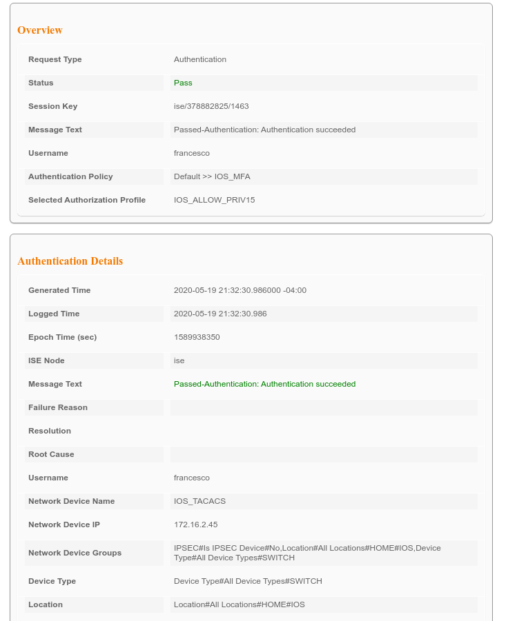

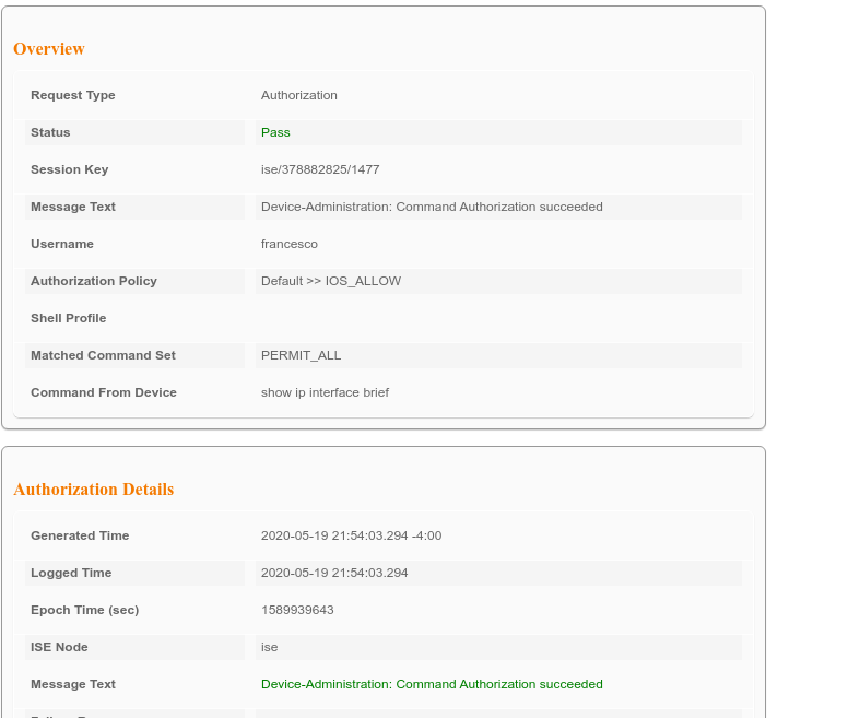

You want to connect on a device using tacacs and getting a push from Duo for authentication and if ok then push a shell profile. If so then it is possible using the proxy radius which I believe you refer to Duo Proxy?
Below my authproxy.cfg
Then on your ISE, configure the Identity source sequence to have both your MFA Proxy Radius and AD and reference it in your authentication policy for tacacs. Rest of the configuration on the authorization side remains the same.
Screenshot from 2020-05-19 21-46-41.pngScreenshot from 2020-05-19 21-46-55.pngScreenshot from 2020-05-19 21-47-29.pngScreenshot from 2020-05-19 21-47-39.png
When you connect to your device, you enter your username and password, got a push from Duo you need to accept and you're connected.
You can increase the timeout to avoid any issues.
Screenshot from 2020-05-19 21-51-10.pngScreenshot from 2020-05-19 21-54-21.png
Hope this answers your question
