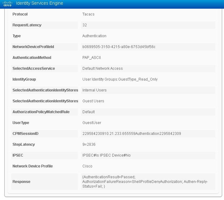

I'm using Cisco ISE 2.3 for Device Administration (TACACS). One thing I want to try is using Guest Account created from Sponsor Portal to be using in Device Policy Sets for Authentication and Authorization.
First, I created 2 Guest Type called: Monitor & Read Only
Second, I created an account from Sponsor Portal and assigned in Read_Only Guest Type:1a7182f9-99c3-4c25-b70a-3916a5003594.jpg
Third, I setup the Device Admin Policy Sets. Now, I focused on Authorization Policy since the Authentication Policy is work for me.
After I save the policy above, I tried to test AAA on a Cisco Switch. Unfortunately, it fails on Authorization and got default Deny Shell Profile. Below is the result:1a7182f9-99c3-4c25-b70a-3916a5003594.jpg
I still don't know why the Authorization policy rule doesn't work for IdentityGroup. Does anyone here ever try this scenario before?
Thank you in advanced
Arie
Arie --
I would like to tell that there is a bug:
CSCvh12508
It makes authorization rule can't read the guest database and that's why my authorization rule doesn't work with guest type identity group.
