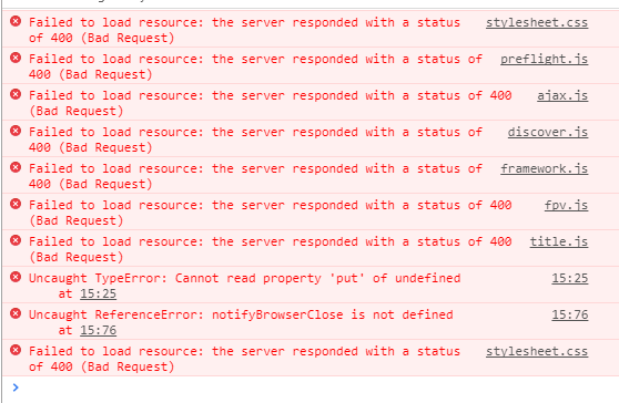

I'm trying to access the web interface for running commands on a Cisco 3550 running c3550-ipservicesk9-mz.122-52.SE (the tar version).

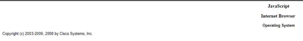

I can access the main interface with no problem if I go to the direct IP address in Chrome, but when going to [my-ip]/level/15, I get a bunch of 400 errors on a broken page as shown below.
If I delete the /html directory from flash:/3550-ipservicesk9-mz.122-52.SE/, it works and shows the page I'm looking for without any issues. But, when I do that, I lose the monitoring interface... which isn't something I want to do.
What do I need to do to get both pages working in parrallel?
