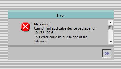

Thanks for the reply Joe.
I did as you suggested (the previous 3750 package was v8.0), however, now whenever I try and use CiscoView for any 3750 I get the message shown in the attachment. (This included 3750's that used to work perfectly with CiscView)
Any idea's how I can fix this?

It sounds like the package was not installed properly.  How did you install the Cat3750 package?  Did you install the other supporting packages as well (i.e. DtShare)?

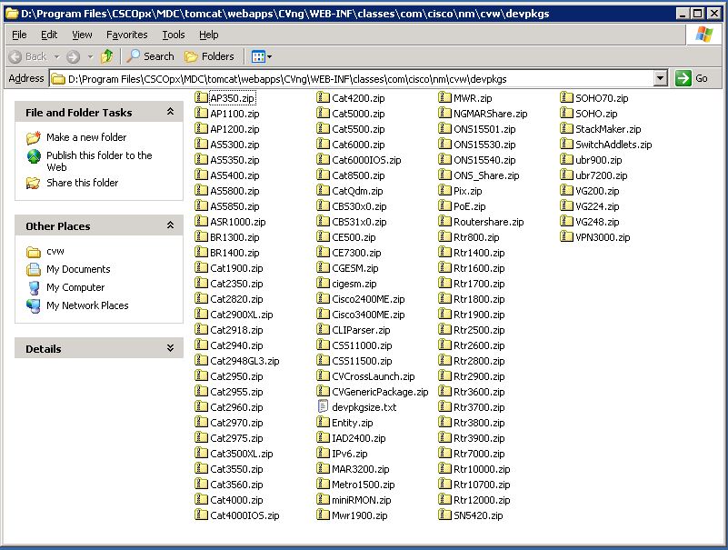

Post the list of files under NMSROOT/MDC/tomcat/webapps/CVng/WEB-INF/classes/com/cisco/nm/cvw/devpkgs.
As requested Joe.
Thanks alot for your help with this...
