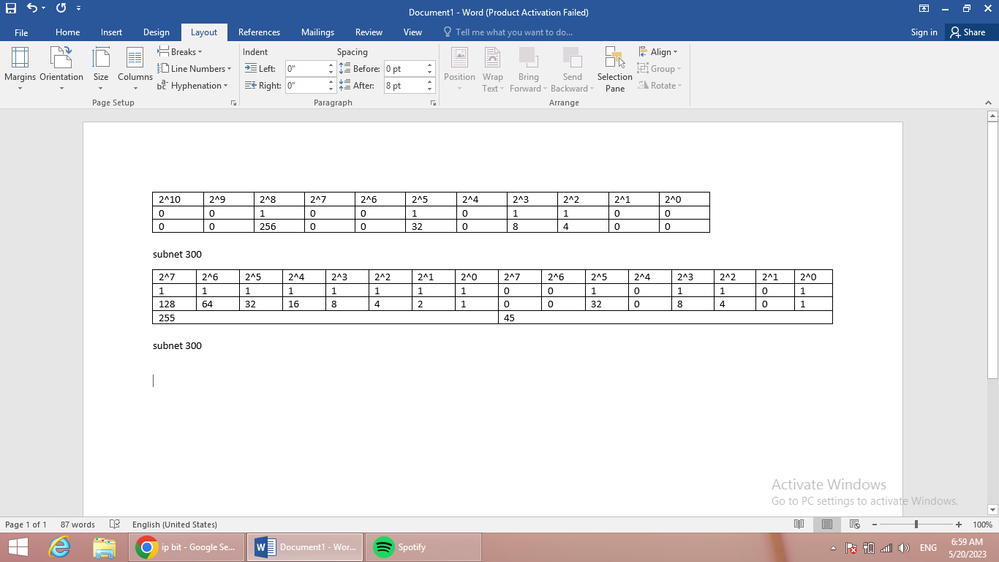

these two table select the correct one
we can not write the IP in decimal->binary convert directly we  must divide the bit into 8 bits, that why IP contain ""."" in-between you take each part convert it to binary
and again his Q is wrong there is no thing called subnet 300.
and again dont waste your time with this calculation you need some acknowledge  to know the IP and it bit and use online calculator
Hi @MHM Cisco World ,
What the original poster refers to is the 200th and 300th subnets. Given that the basic network is 99.0.0.0/8 and that the subnet length is /19, it leads to 11 bits for subnetting (2^11 = 2048), therefore 2048 /19 subnets out of that 99.0.0.0/8.
These 2048 subnets will start with 99.0.0.0/19 (1st subnet) and runs through 99.255.224.0/19 (2048th subnet).
So it is a very legitimate question.

Again, I'm not against using on-line (subnet) calculators, but the one you're using appears to be really doing CIDR prefix calculation, not Classful subnet calculation.  For instance, in your image, it notes the "IP Class" for the 99.25.0.0 is Class B, well that's incorrect!
