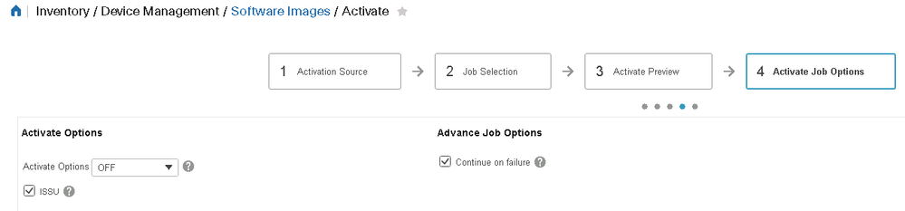

I experianse some issues with ISSU Update per Prime Infrastructure 3.6, may be you have some idea what the problem is?
I'm going to upgrade cat. 4500X from .SPA.03.08.06.E.152-4.E6 to 03.08.08.E.152-4.E8. First I distributed the new Version via PI 3.6 to the VSS "insert boot command" and "ISSU". In the second step I activated the image with ISSU option and logged all commands, issued by prime
What prime does:
copy	bootflash:cat4500e-universalk9.SPA.03.08.08.E.152-4.E8.bin bootflash:cat4500e-universalk9.SPA.03.08.08.E.152-4.E8.bin slavebootflash:
terminal	length 0
dir	slavebootflash:cat4500e-universalk9.SPA.03.08.08.E.152-4.E8.bin
dir	bootflash:cat4500e-universalk9.SPA.03.08.08.E.152-4.E8.bin bootflash:cat4500e-universalk9.SPA.03.08.08.E.152-4.E8.bin
show	file systems
delete	bootflash:
archive	tar /xtract cat4500e-universalk9.SPA.03.08.08.E.152-4.E8.tar bootflash:
dir	/all bootflash:
copy	ftp://user:password@ip/cat4500e-universalk9.SPA.03.08.08.E.152-4.E8.tar bootflash:
dir	bootflash:cat4500e-universalk9.SPA.03.08.08.E.152-4.E8.tar
show	ip http server status
dir	slavebootflash:
dir	bootflash:
show	file systems
dir	/all bootflash:
terminal	width 0
terminal	length 0
enable
Thats it. both prime jobs are listed as successfull, for the second jop PI didn't issued a single command. And there isn't a single command about ISSU.

Do somebody has an idea, what the problem is?
thanks
p.s. Prime is also not able to upgrade VSS without ISSU - in that case PI just reloads the standby switch and closes the job as successfull.
