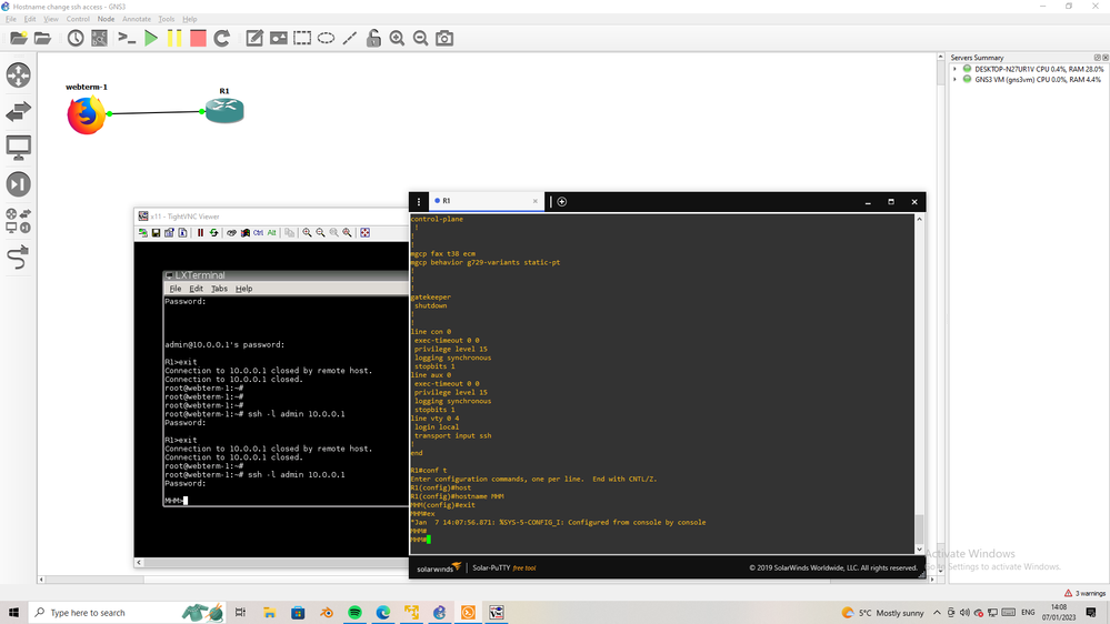

I run small lab
config ssh use username admin password admin and hostname keep default R1
I can access to router via SSH
then change the hostname to be MHM
and you can see even without re-gernate key I can access router via ssh.
hope this lab help you.
if you have Q please share here

that so good if you can access via console
for my lab I change hostname and I can access via SSH without re-generate the key.
if any one can offer console access to be safe, since you are more cautious its your own call.
as we mentioned changing host name not cause any issue - i also suggest method of 2 sessions to test it.
