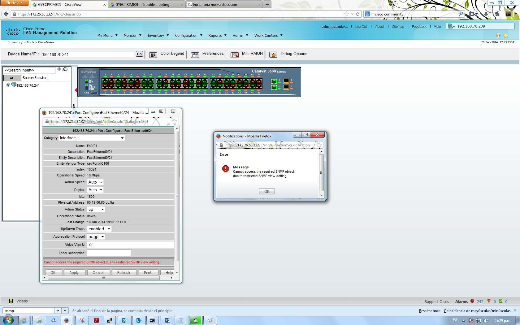

Buenos dias.
No puedo realizar ninguna actividad con los puertos a traves del cisco view. me sale un error.
Message
Cannot access the required SNMP object due to restricted SNMP view setting.
Ya configuré en el sw cisco la version snmp3.
Good morning.
I can not perform any activity through the ports cisco view. I get an error.
Message
Can not access the required SNMP object due to restricted SNMP view setting.
Since I configured the cisco sw version snmp3.
