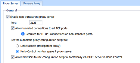

Now as I mentioned, when I connect any client to any VLAN network, either on WiFi or Hardwired I have extremely slow, sometimes no connection when browsing the web. Kerio NG510 has a non transparent proxy, which when used on the client allows perfect internet connection.
