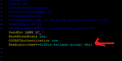

This worked for me, thank you.
sudo nano /etc/ssh/ssh_config
[Enter Password]
Locate the line ‘ #   Ciphers aes128-ctr,aes192-ctr,aes256-ctr,aes128-cbc,3des-cbc’ and remove the Hash/Pound sign from the beginning.
Then paste the following on the end; (bottom of the file) then save and try again.
HostkeyAlgorithms ssh-dss,ssh-rsa
KexAlgorithms +diffie-hellman-group1-sha1,diffie-hellman-group14-sha1

The server offers "diffie-hellman-group-exchange-sha1" and "diffie-hellman-group14-sha1". These are older algorithms, possibly disabled by default on your SSH client due to security concerns (Mac did this a few years back). Use ssh -vV <IP_ADDRESS> to see detailed debug output, including supported algorithms by both client and server.
This is a temporary workaround and weakens security. Edit your SSH client configuration to allow the specific algorithms offered by the switch. Add KexAlgorithms=diffie-hellman-group1-sha1 to your SSH configuration.

I seem to already have this line in my ssh_config file, yet it doesn't work.
