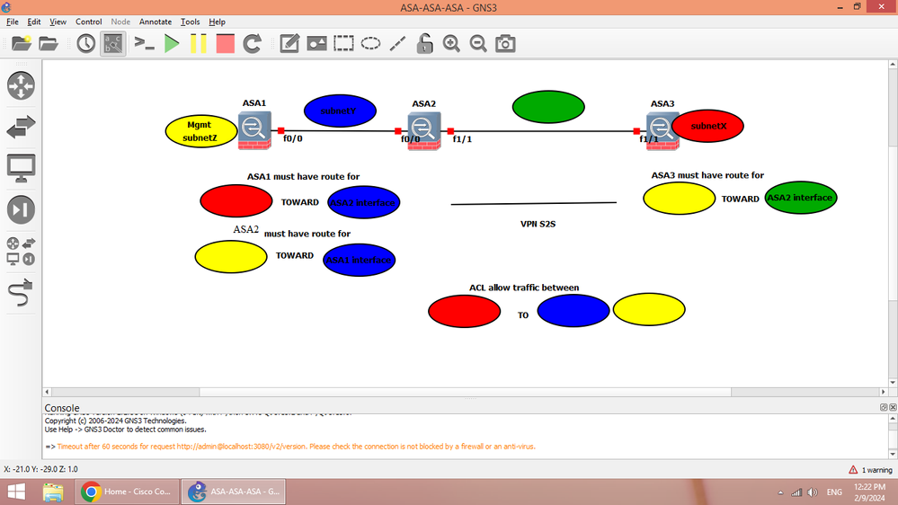

to make it clear for both I make this topology
please check it and write note if there is
