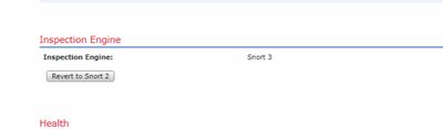

We haven't experienced this issue with ours. We don't have specific SNORT configurations setup for V3, we don't use the earlier versions. From my understanding you have been on version 7.0.X for some time and are using snort 3, which is the default for all FMC's on 7.0 and above. Are you using the basic snort rules, or have you modified them? Also is there any way that reversion to snort 2 could have happened? Devices > Device Managment > Device > Inspection Engine. I too am not sure what it could be but if everything worked fine up to now, no changes to the FMC or FTD's that are managed I would look at what snort is doing. Unfortunately, there doesn't seem to be a way to back out an installed SRU and revert to an older one.

A summery update from the TAC engineer below:
I have gone through the collected outputs. After checking the outputs and referring internal cases, the device appears to be hitting following defect:
https://bst.cloudapps.cisco.com/bugsearch/bug/CSCwa85492
The defect has been resolved in 7.0.5 release:
https://www.cisco.com/c/en/us/td/docs/security/firepower/70/relnotes/firepower-release-notes-700/bugs.html
In my opinion its is better to stay with my snort version rather than going back to snort 2 since i have a very disappointing problem encountered with high memory usage, So is there anyone tried upgrading to 7.0.5 FMC and FTD? do you find it pretty stable?
