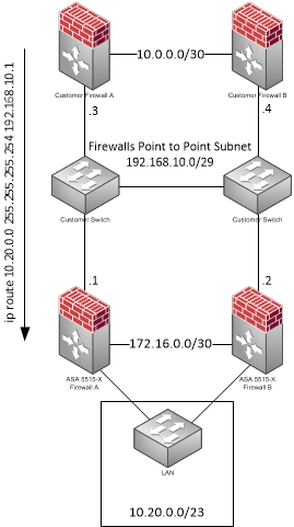

I amin the process of configuring a pair of Cisco ASA 5515-X Firewalls. Firewall A has 5 connections and Firewall B has 6 connections so I don't believe an Active/Standby configuration will work in this instance as they go to different networks so will need both Firewalls processing traffic.
I also have a connection to a client's network and they have provided  a /30 subnet to use as a P2P link (192.168.10.0/30). They will use my interface address as their next hop address for routing to my networks.
What I am trying to do is to configure the Firewalls so that the interface they will use as their next hop failovers to the standby Firewall. I think you can do this when in Active/Active or Active/Passive but I am not so sure how I go about this. I think multiple contexts with groups are used but I wouldn't know where to start or if I am indeed correct.
I have attached my topology with example interfaces and addresses. Mine and the client's Firewalls will connect via  L2 switches.
Can anybody help me please and provide explanation of the solution?
Thanks in advance :)
EDIT: Updated topology attached. The customer has actually provided a /29 subnet  for the P2P links, however they still only wish to use one addaress for the next hop. I need to find a way for both my Firewalls to both be passing traffic and for the 192.168.10.1 address to failover to the secondary Firewall if the normally active fails.

Hi Aditya, thanks for your reply.
See updated topology attached and in the OP.
From the new topology:
  • The customer has actually provided a 192.168.10.0/29 subnet for the Firewall P2P links via the Switches (running at Layer 2)
  • Both my Firewalls require to be active due to having a different numbers of connections (I've only shown the LAN but one Firewall has 3x external networks and the other has 2x external networks so both Firewalls need to be passing traffic)
  • I have a failover link between my two 5515-X's in the 172.16.0.0/30 subnet
  • The customer will have a static route to my LAN with a next hop address of 192.168.10.1
  • 192.168.10.1 will be configured on the active Firewall, 192.168.10.2 will be configured on the secondary Firewall
  • I need the 192.168.10.1 address to failover to the secondary Firewall if the active Firewall fails. This is the problem I am trying to resolve
I am pretty sure this can be solved using multiple contexts but I am a little unsure how these work.
Hopefully you can help :)
