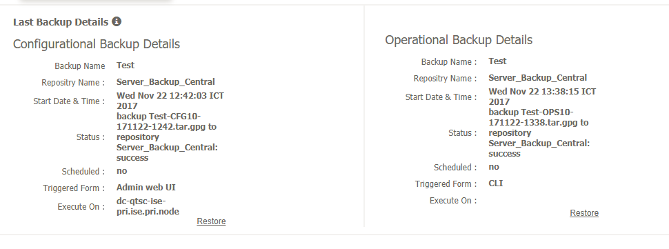

I have a scheduled backup Configuration and Operation data Cisco ISE using SFTP server. When the schedule is execute, it created a 0 byte size in server. But if I use local disk repository, backup files were created normal. Is there something wrong?
The output information after backup :

anluarsa11
Check the disk space or permissions on remote directory.
In my case it was due to disk space.
Michael Weller
Hmm, old issue.. we do now have the same problem, but when backing up directly to an Azure Blob Storage through the Azure provided SFTP connector. Setting this is up wasn't so easy given all the password length etc restrictions. But now it does also report 0 filesize and bogus (0) dates. Double checking the files with WinSCP did not show any issues. Proper modification time and size.
Seems like a display issue and incompatibility with Azure SFTP. Other repositories local or SFTP to a real linux host work fine.
