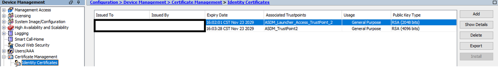

hello to everything, I have a query, I would like to know if there is a way to change the expiration date of identity certificates on a 5585-x handle since at the time of generating it it generates it for 10 years and I need it only for 1.

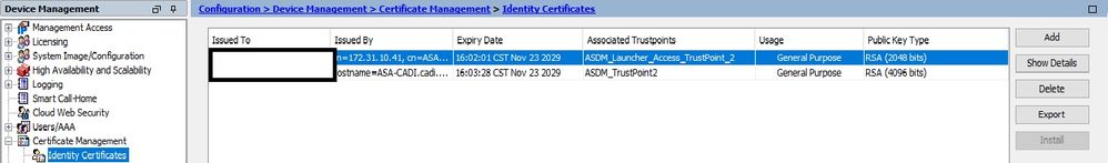

Hi  Luis_Regalado,
Considering that looks like a selfsigned cert, this expiry date come by default and can't really be modified.
The fact this is valid for 10 years will not make any difference since if after a year you want to remove this one and create a new one to refresh it you can do it without any problem.
Hope this info helps!!
Rate if helps you!!
-JP-
