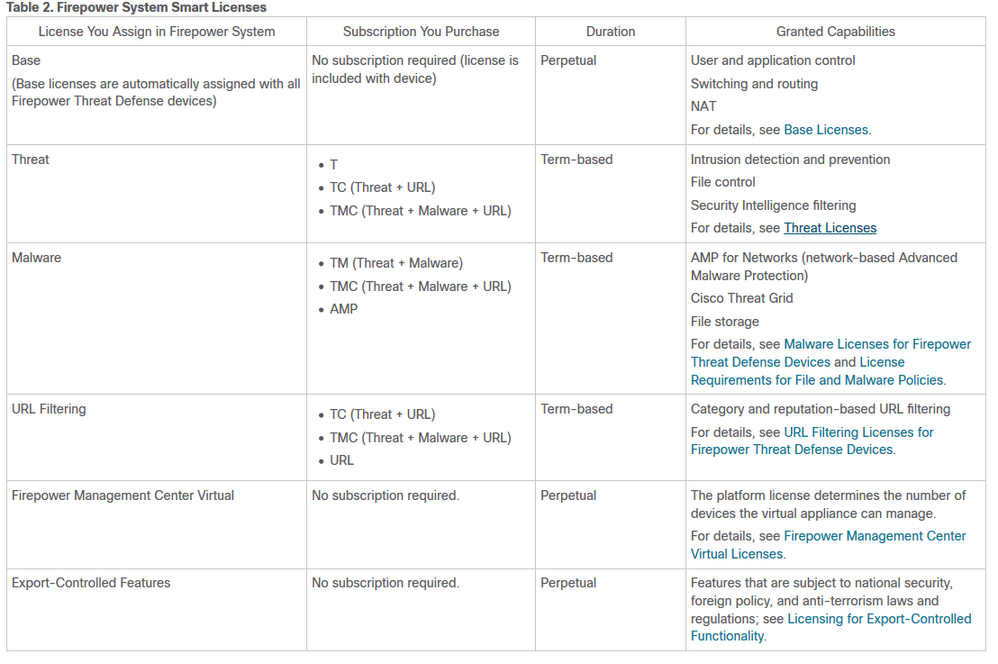

To download the FTD firmware you need a service contract in place between cisco and you company. In regards to SMARTnet license I have pasted below information from cisco website. here all the information is how to setup a smart lic. cisco firepower license come with 1/3/5 years subscription.

Thank you, Sheraz, for the elaborate response. You explained it well. The only remaining question relates to the point your raised regarding the required licensing. I bout SMARTnet license. That's how I downloaded the FTD firmware. Is that what you mean? but the SMARTnet license is valid for only limited time. What will happen after the perid ends? I won't be able to download updates only or the FTD will completely stop working or only some features will stop working?
please do not forget to rate.
Thank you for your explanation. I can see that half of the components in FTD are perpetual, and perhaps the perpetual part of FTD is almost equivalent to ASA, so even if the term-based part expires, the FTD is still an attractive option.
