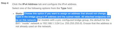

BVI group has been created and Eth3 and Eth4 are the members. BVI1 has been assigned static IP address.
However, when I connect end points, I get 169.x.x.x APIPA address.
this meaning that you not enable DHCP server in BVI interface you add
enable the DHCP server for BVI interface
@MHM Cisco World So I should not assign static IP address on BVI1 interface?
Do you have more specific steps /screenshots for follow?
NO friend you need assign IP to BVI but also you need to enable DHCP server in this interface to make endpoint get IP from ASA BVI.
