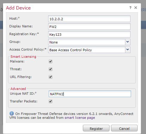

FTD1 is joined to the FMC successfully. I have configured a NAT rule and firewall rule on FTD1 to allow incoming connections to the FMC on FTD1's WAN IP (1.1.1.1) on port 8305 and 443 (for testing). I can access the FMC's web interface at https://1.1.1.1 via the PC behind FTD2 so I know this is working properly.
I then tried to join FTD2 to the FMC. I configured it with local management and set the interface IPs and enabled the default inside to outside NAT rule.
I executed the following command from the CLI of FTD2:
configure manager add 1.1.1.1 Key123 NATFW2
Then see the attached screenshot of my configuration to add FTD2 to the FMC.
Unfortunately the join fails with the following error "Could not establish a connection to the device"

You won't be able to route to 1.1.1.1 if the mgmt interface is on 10.2.0.0 network and plugged into the inside network. Put the Mgmt and Outside interfaces in 1.1.1.x network, they can then reach the address 1.1.1.1
Ah ok, I can do that in a lab, but in production i'd need to put a router in front of the FTD? That's disappointing as I was hoping to implement with as little hardware as possible for simplicity and cost savings.

Followed the below steps, and I have successfully registered the FTD with FMC behind the nat using NATID over the internet:
"You will need to create a static NAT of the firewall in front of the FMC, to nat tcp/8305 to the private IP address of the FMC.
On the FTD when configuring the manager, use a natid. E.g "configure manager add <public nat ip of fmc> <registration key> <natid>".
When registering the device on the FMC, the IP address you'd enter is the private (real) ip address of the FTD, in the "Unique NAT ID:" box enter the natid configured on the FTD"
some additional points to be considered for FTD mgmt network configuration as per below:
"You won't be able to route to 1.1.1.1 if the mgmt interface is on 10.2.0.0 network and plugged into the inside network. Put the Mgmt and Outside interfaces in 1.1.1.x network, they can then reach the address 1.1.1.1"
