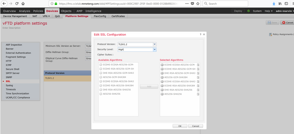

I don't see any place in the GUI (or a configuration guide reference) to change that.
You can however change the settings for managed sensors under Devices > Platform Settings > SSL.
Here is the output of my FTDv with SSL VPN enabled. Interestingly it still shows some CBC parameters despite their not being chosen in the platform settings:
