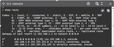

In the IP router table i can see the firepower under 192.168.1.114. However, I cannot ping this IP nor can i ping from the inside (CLI from 192.168.1.1) to the outside.
In the attachment you see the routes I have set so far.
Does anyone know what Iam missing?

It looks like you have the 192.168.1.0/24 network defined on both the inside and outside. Those need to be on different subnets.
Also, you haven't shared the management setup ("show network" from the cli).

Each interface of the firewall must be in a different subnet. You have the inside and outside interfaces in the same subnet. Since outside appears to be DHCP-addressed, you must change your inside subnet from the default 192.168.1.0/24 to something unique.
The getting  started guide for these devices is really quite thorough and should be followed, adjusting to suit your conditions.
https://www.cisco.com/c/en/us/td/docs/security/firepower/quick_start/fp1010/firepower-1010-gsg/ftd-fdm.html
brunosa3
thank you so much !!! That was the trick!!!
